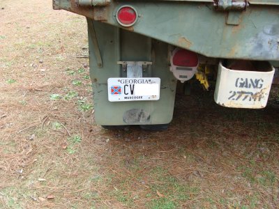

We were able to tag and insure my old deuce. I used an old bracket from god only knows where that I think my dad had lying around long before I had it lying around. So now the challenge is I have to install a tag light. I would really like to avoid a citation. Because money is so tight I would like to use something I have lying around and make my own 24V light. I have plenty of stuff to use if I could install a 12V. So does anybody have any ideas, thoughts or suggestions?

You could just use two 12V bulbs for your tag light, wired in series. You will have to find a light that has two wires, and does not rely on its mounting for a ground. A very cheap way to go would be to (now that Christmas is over) use a string of clear or white Christmas lights. Count the number of bulbs on the strand, divide 120 by that number, and that tells you the voltage each bulb uses. For instance a 50 light strand, is using bulbs that run on 2.4 volts each. To use up your 24 volts, just take 24 and divide by 2.4, which gives you 10. So you would cut 10 bulbs out of the strand (make two cuts, one on each side of the string of 10), bundle them up, put them in a regular lamp case, and walla... A very merry tag light. LOL

That link has some col stuff. I was going to do just like you suggested and install the tag under the tail light. But it looked as though it would hang in a bad spot and be prone to damage.
Do not htink I will not try the Christmas light idea. I would do it just to see what it looks like.
I think I have a solution. I have a few things I have to dig out first though.
