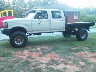

I have a flatbed on my 93 CCLB 4x4. I love it. My truck is on 37's as well. I wouldn't go back to having a regular bed. I have removable sides that fit in the stake pockets. The bed measures a little wider that 6' and a full 8' long. I can get you some more pics later if you would be interested.

my only concern is hauling gravel and dirt. I guess if the sides were build solid enough it should be fine?
what size steel did you use for the perimeter and cross members?
your bed height is very good, looks tough and not droopy.
what did you do to make it sit up so high?
eastsideauto
May 10, 2012
310
Denton, NC
The perimeter, headache rack and center rails are 3" c-channel.. The crossmembers are 2x4 steel tubing spaced every 12". You really cant tell it from the pic but the bed sits on 4x4 steel tubing 1/4" wall so the rise of the frame over the rear axle did not factor into the install. There are a few more things I want to do to it but it is great for now.
