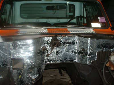

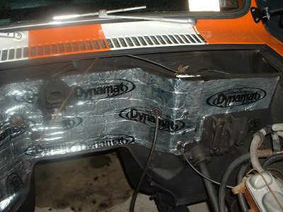

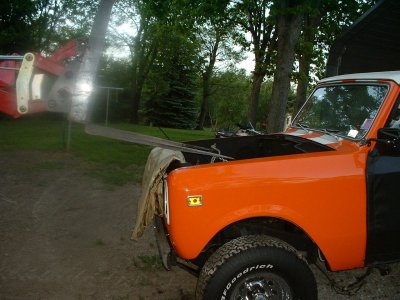

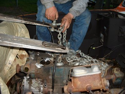

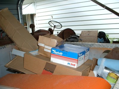

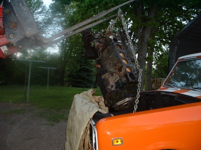

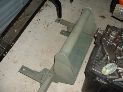

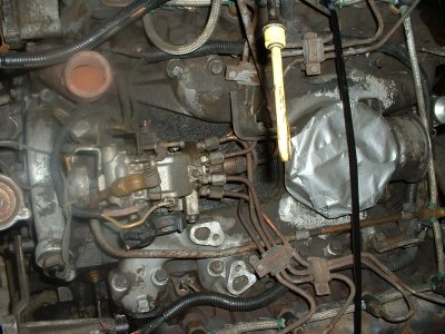

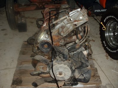

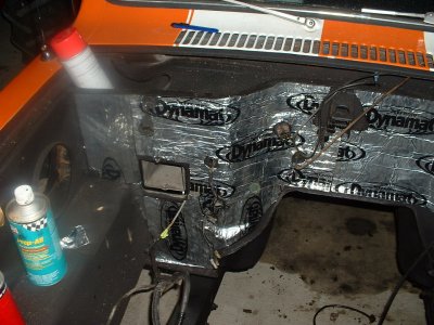

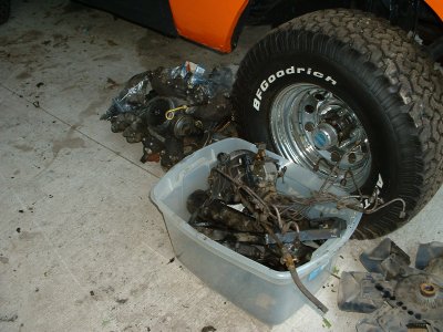

here's ...some...pictures, motor's at the macine shop, bos is full of parts and there's another $900 of special order parts at the auto store.
oo anybody know where i can get injection lines for under $65 a piece?!! :mad: cookoo

transfer case
Why don't you use a divorced NP-205 out of a IH truck or travelall. Should handle the torque from the 6.9 okay. I own a 1980 Terra turbo diesel wide ratio 4 spd 4.09 axles. It was in Peterson's 4 wheel & Off Roads first readers rigs issue. I also own a 83 Ford F-250 6.9 4 spd 4wd pick-up. I enjoy both the the scout is really crude compairs to the Ford. Are you going with the hydraulic clutch setup?

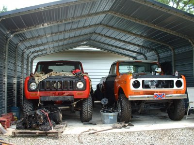

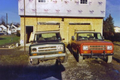

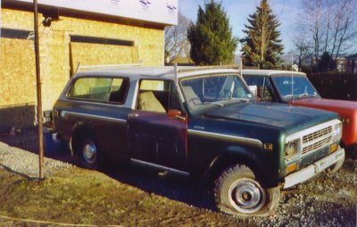

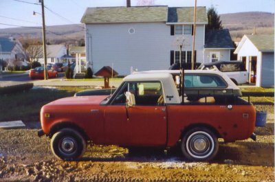

here's the "trucks" that went into making mine, MY orange one is the truck on the left (green) the red one was cut up and the best parts were put into mine. and a few other pics i have.
