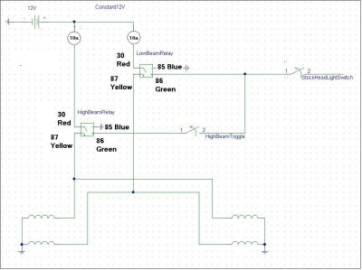

Ok 75% done today with a slight change of plan. I'm gonna instead of using the stock high beam switch, I'll add a toggle on the dash to trip the highbeam relay. This does two things; high+low beams when I want with no diodes needed, and an easy flash feature.

Ok some initial pics of the install.
I picked up from napa relays, pigtail/sockets for the relays, a fuse block, and a green lighted toggle switch.
As an aside I'm adding in my air horn circuit in with this harness and hookup so thats why there are three relays.
This is the harness mocked together out of 14g wire. Not too much to it other than one at a time string a line from where you are to where you want to go labeling each one. I then grouped the wires by colored zip ties with the horn, high beam, and low beam power wires with blue ties, the horn, high beam, and low beam trigger wires with white and long enough to go into the cab. Also tagging along is a ground, and a constant 12v for the CB.
Here is where I chose to mount the fuse panel and I ended up using 5 circuits. CB, Horn, Horn relay (since ford horns are ground triggered there needs to be a positive source feeding the relay), Low beam, and High beam.

Continuing with yesterdays pics...
Here are my three relay connectors wired together. Incorrectly actually, but that doesn't show up till later, and of course when it ain't as handy to fix.
And I noticed it after I had it all wire tied together.
But this is a good spot to talk about relay tech and the two ways to wire one. 12v across pins 85-86 trigger the coil inside. This can be done by grounding one pin and switching the hot 12 volts to the other. Like what is going on for the headlights. The other way is to have constant 12volts to one pin and switch the ground. This is how the ford horn buttons on cruse control optioned trucks are, and not what I was thinkin up above makin a permanent ground for the horn relay.
So you can see how the blue wires for the two light relays are to ground, and the blue wire for the horn relay going to a low amp circuit.
