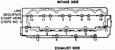

I can't find my torque pattern for my 7.3 motor. I know there is 2 patterns that needs to be followed but don't remember where I stashed it. Thanks guys.... :confused:

This auta-do
First step, 65 ft lb . numbered seq.
Second step, 90 ft lb . numbered seq.
Third step, 110 ft lb . line seq.
