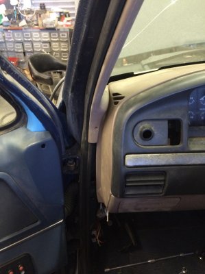

has anyone done a OBS dash conversion in their brick nose?

curious if the gasser column is the same as a diesel.

sweet. just purchased one from a 96 bronco.
hope it works!
gonna be slapping the rest of this dash together today for mock up, then pulling it apart to paint it.

You missing a steering wheel ..Just saying
correction, im missing the entire steering column!
bought one offa flea bay this morning, itll be here next week.
here is the prelim fitment with OBS heat/ac portal installed.
gonna need some vents and such... nothing major!
gonna take it back apart,paint it, and slap her in!!!
seems like most stuff will bolt right up, with the addition of a few zip screws.
had to make a slight incision.
nothing too major.
dont know how this will work with the column, but that will be answered next week.
gonna need new HVAC controls, the one i have is damaged.

93 aerostar col8mn for obs style...auto manual no diff...auto lever is easy to remove.
In my yard a customer snapped gear lever in aerostar...pulled it...tore apart my auto obs column saved day!
I ***** YOU NOT GUYS......OME CABLE BRACKET FOR AUTO SHIFT CABLE WAS DIFFERENT...THAT WAS IT
Um, the auto shifter means there IS a difference. Yes, they're INTERCHANGEABLE, but they're NOT the same. If you're replacing a broken, damaged, worn-out, etc. column, you can easily swap the covers. But the OP is building from scratch, so he'll need the column that's appropriate to the tranny that's going in.

I might have some, Il have to check the condition they might be broken. how soon do you need them?

I have the 2 passenger side vents, that are still good. The heat and A/C controls, they have the cables and vacuum lines. I also have the wire harness for the dash.

Dumb question, but you know about the difference on the side "wind-wing" windows, right?
Note the slightly different design, with the front end blunted instead of being pointy like the '80-'91 trucks have.
If memory serves, Ford had to redesign the window with the corner cut off, because the older design interferes with the OBS dash and won't swing all the way open. If the owner doesn't use them, it's a moot point; otherwise you want to find wind-wings from an OBS truck...
