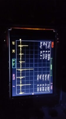

For rpm, yes you could use the tach sensor (as Hertz, since the stock sensor outputs AC), for timing, no... we need that zero mark on the harmonic balancer to figure out where in the cycle the injector event occurs.
BDCarrillo
Jul 19, 2014
1,245
10
Abilene TX
This is an individual pulse, as tested on a truck with the positive probe on the factory timing sensor, attached via soldered tab. Ground was the injector line nearby.
A set of pulses.
Sooo... looks usable, with a more pronounced negative spike compared to positive. The peaks seemed to travel from a negative high to a positive high. I'll have to do some research on that and see if it's piezo crystal harmonics or sensor fatigue.
Next step will be cleaning and filtering that signal on the hardware/electronics side.

I bet it's real. It's probably the line expanding with the plunger compressing the fuel, dumping the fuel and the fine structure is probably a little ring down. Cool. I'd love to see what a standard line clamp sees in comparison.
Really cool man!

Well that's as much as I could clean it up, even with a full bridge rectifier. It's like twanging a guitar string, the frequency of each injection looks like a sound wave. The main problem, is that each "twang" of the injector hits at different parts of the natural harmonic of the piezo crystal. Constructive and destructive interference plays havoc, thus the odd peaks/valleys... but they are at the right time, and respond to changes in RPM.
Thar she be:
There's a thin chance I could bump up that measly 2v signal to trigger a timing light with a big ol' op-amp. Note that I'm getting 2v now because it's run through a full bridge rectifier.
Disclaimer: I ain't no electronical engineer, wrangling ones and zeros.

I bet you could integrate your way out of it. I think that's probably what the timing meters do. I bet they sample and integrate because I doubt they update the screen every 2 milliseconds. Seems like if you could integrate for a couple seconds, you could average that out enough to be fine. You are just looking for the delta between the injector and the mag probe. Maybe just set a threshold so you are just looking at the bigger peaks? Something else I'm sure you have thought of but technically if you are using #1, you only want every other crank signal. 1 of the pulses will be 180 out.
