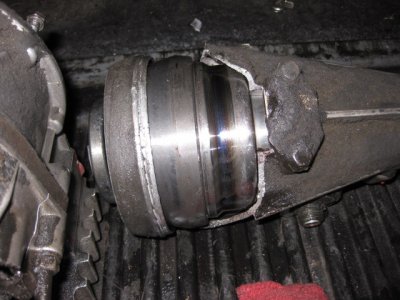

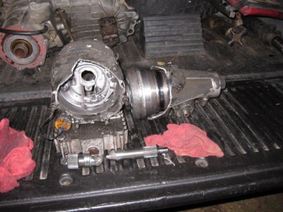

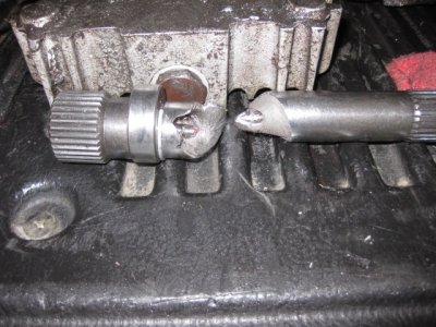

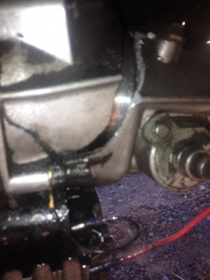

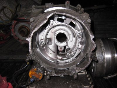

GV got killed in grand fashion this weekend. The leadup to it's destruction is still being debated, but the facts speak for itself. the mainshaft was twisted in two due to torque reversion. Good thing was the Sulaco was not towing anything at the time it happened. yes, the guy in the pic was the operator at the time. we'll see what happens to that smile when he gets the bill for the replacement GV.
see pics.

What in the world happend? Anything can fail, but as far as I can remember this is the first time I've seen a Gear Vendor buy the farm in such a dramatic fasion. Surprised it happend without a load involed.
Please let us know what you find out.

it could have been an old battle wound that was fatigued enough it finally gave up the ghost. not all failures happen when a vehicle is fully loaded, some wait lurking and can blow at any time.

You should contact gv and see how much they will pay to delete this thread :D I don't think you are running 2000hp

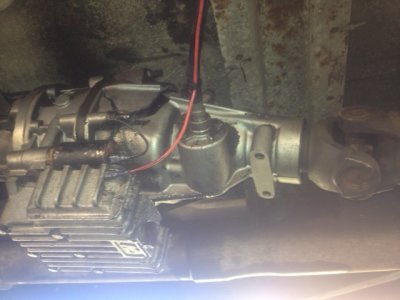

that will teach you to not jack the truck up by the gear vendor... even if it means you can rotate all 4 tires at once! :) HAHAH
...oh wait i see the power wire is disconnected ;)

Almost looks like some kind of wild drive shaft unbalance to break it like that. Perhaps a bent drive shaft? Or a loose rear end? The only time I've seen the rear of a transmission break like that was when the spring perches broke off and the diff rotated under load.
that's my guess.usually how it happens it seems.not necessarily the drivers fault,but just age and ware until then eventually just fail.
the odds are,the GV unit broke on the driver,not the driver broke the GV.

Unless, of course, the driver was trying to shift into a higher gear (or even neutral for a sonic blast) and got reverse instead. 6500 lbs of truck going the opposite direction of the transmission will do amazing things.

Downshift from 5th to 4th but hit reverse... I don't think you could get the shifter into reverse easy at any road speed without grinding.

I was presuming it was automatic. I've seen whole transmissions puked out from a drive-to-reverse shift under hard acceleration.

I believe this truck is a dually and it has a ZF5 speed trans in it. I can't really see all the broken shaft but I know Calvin has seen it. Maybe sending that shaft back to GV will help them to find out what happened. Might be a mictscopic crack that developed and a sudden torque from shifting hard broke it. then all hell let loose causing the case damage. Have never seen this kind of damage but have been told of it by the original poster... Sad ending to a great aux trans. Clearly something happened to cause this kind of damage... We have not heard the last of this I'm sure... With all my hp and torque I would have thought I would be the member sharing these kinds of pics long before Calvin did...

Having driven this truck (thankfully, I'm not the operator who killed the GV), I can say with certainty that it's a ZF5...and, IIRC there's a gate in the shifter assembly that makes it impossible to pull the shift lever down from 5th into Reverse (although I suppose that could have failed if you pulled hard enough :shocked: )...the gate makes it so that you (theoretically) can only shift into Reverse from Neutral.
In any event...HOLY MARY :shocked: :shocked: :shocked: I had seen a couple of pics of the cracked case, but didn't realize there was so much carnage inside...that's downright scary :shocked: Was he on the highway when it let go, or was he in town at lower speeds? At least nobody got hurt...
