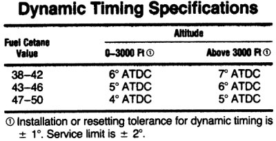

It actually should be pretty close if he timed it to 5 deg. ATDC via the lumi method. Of course, this is done at 1400 RPM, not 2000 so that does raise a bit of concern.

he timed using aluminoscoty type deal from what I remember.
i used to time via lumy and i really enjoyed it.it was very successful.you just need to have this chart,or else it's no good.
@1400 RPM though as mentioned above.

F250 I will print that chart out and give it to the guy, thanks !
