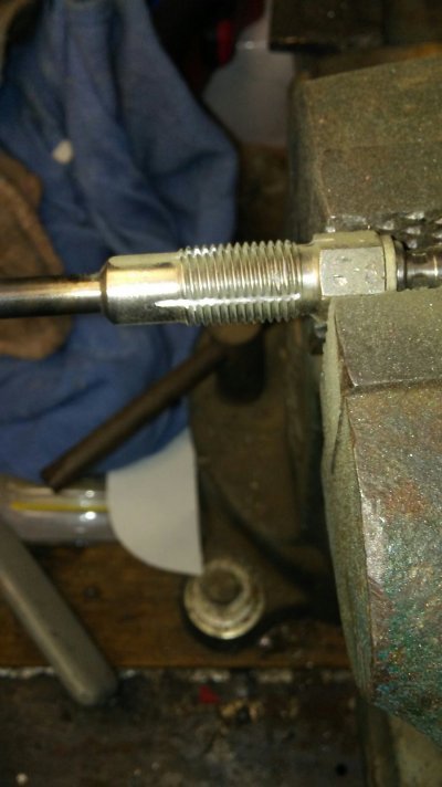

Thanks TNBrett,
I picked up a tap and die today, 10mmx1.0, tried the die on an old glow plug, but the die takes off way to much material. Got the Dremel tool out, made a thread "chaser" out of the old glow plugs, as you suggested. Ran a bore brush down the threads with some carb clean to break up carbon. I used some extra sticky assembly grease on the threads of these thread chasers, to catch any metal, metal shards stuck to the thread chaser grease.
Where I cut the old glow plug with the die, the diameter of the peaks of the threads measured 0.020" less than the uncut threads. The tap that I got measured 0.0045" larger than the glow plug threads. That would be a lot of slop 0.0245!
So glad that I did not use the tap and die! It must be a thread chaser, not a tap or die!

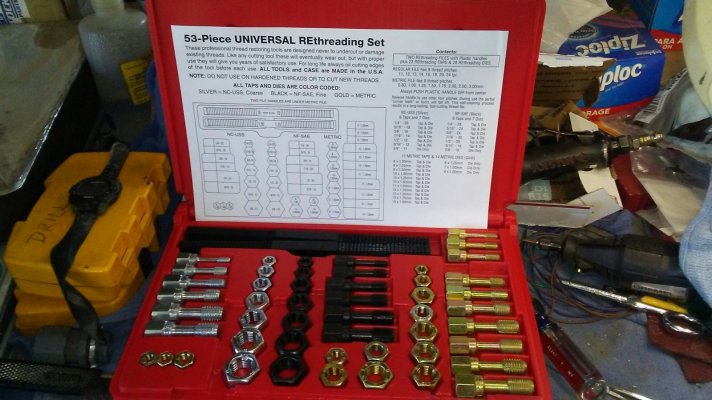

I fashioned 4 of these thread chasers out of old glow plugs, spent a couple hours going in and out. the threads kept coming out galled. Cleaned with bore brush PB, carb clean, air, etc. Still tight, threads galling. Probably would have worked, if I had used this technique to clear the carbon before I tried to install new plugs.
I ordered a CTATOOLS.com 8240 universal thread restore kit off Amazon for $105. Measured, it is not over/undersized, and will not cut new threads, just reform damaged threads.
Worked awesome, 15 minutes later, glow plug #8 went in hand tight to seat, then torqued. Did not over/under size the threads, like a tap and die would have. I measured with micrometer first. Used some sticky grease to catch any shavings. Made in USA.
Making your own thread chaser would work fine, if it was only carbon to clean up, but I think I had a damaged internal thread folded over, that the glow plug chasers were not hard enough to clear.
Just wanted to share this thread restore kit with others, does SAE and Metric.
Autolites/Champion glow plugs removed, Motorcraft ZD9s going in with anti-seize.
Not complaining, just sharing my experience with these glow plugs, hoping it helps someone else.
