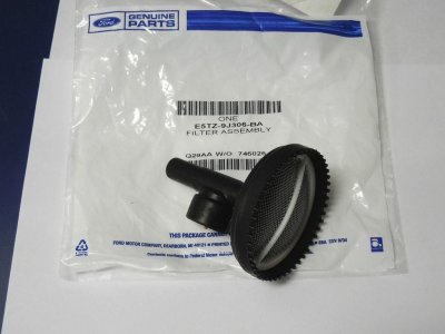

(1) The sending units have easily worn variable resistor plates in them that will lie.
(2) The tank pickup showerheads disintegrate and get stuck in lines or the selector valve.
(3) Air intrusion is possible after changing out the valve, even if you used a vacuum pump. Bubbles can be everywhere.
(4) How old is the IP? Could be heat soak, solved temporarily by cooling off the engine or IP. Did he try starting it a few hours later?
338
Being as it's an 85, the rubber lines crack on the inside, when you wiggle them, like changing the FSV, small pieces of rubber break off, that can plug the FSV, not saying that's the problem, but could be. If the tank is at or below a 1/4 tank, the foot screen may be broke off, if that's the case, ya have to drop the tank(s). Check for air at the filter Schrader valve.
