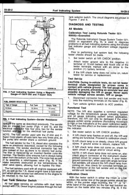

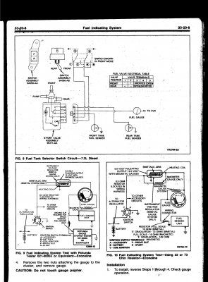

Your going to sink a lot of money into it doing that and the FSV is expensive ($260 dealer) besides they can be trouble some. Your fuel gauge from the front (new) won't register the same as the rear.
You would be better off just installing a 38 gallons in the rear. Usually the front is 17 gal and rear is 19 gal. so a 38 is larger than a double tank and a whole lot easier and less costly to install.
My guess is you would have close to $400 doing your double tank, unless you get all needed from a junk yard. The hangers might be a problem.
