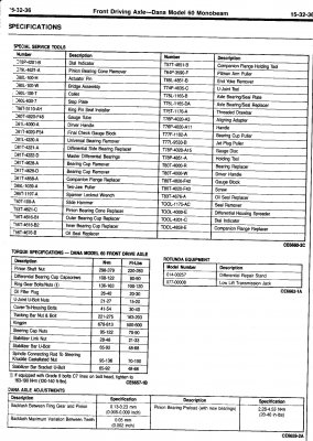

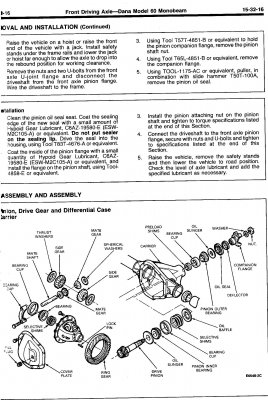

Got blow up pic's of the 60. Soon as I get them scanned I will post on my web shots, prolly take 30 minutes.
342
Here they are Dana 60. If that is not enough PM me for more pic's.
