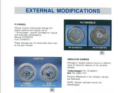

there are 2 different flextplates for the 7.3l idi/e4od.1 for N/A and 1 for turbo.the n/a are a dime a dozen (65$ new on amazon i think i payed last)
but the turbo spec is unobtainium as it's balanced specifically for the '93/'94 turbo engines.if you have one of these,it's worth it's weight in gold.discontinued and a feller is near SOL if one fails him.:eek:
for a used n/a e4od flexplate,id say $20 (buyer pays shipping) is fair
for a rare/discontinued turbo flaexplate $200 (buyer pays shipping) is fair (asking $250 or even $300 shouldn't hurt your feelings too bad either since they're nearly impossible to score alone.)

The stamped one is N/A to E4OD, I'm almost certain. Look at the other side to see if there is a weight welded on. If not it is N/A. If it has a weight, it is from a turbo engine.
