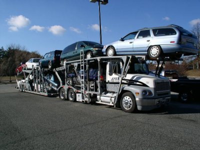

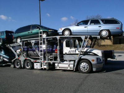

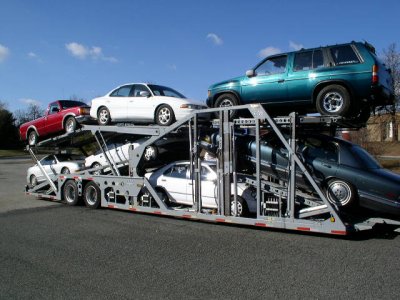

Here's some pictures of the first load. It went from Fallston, MD to Tidewater, VA. Ran OK on the way down but smoked ALOT. Got 10 miles out of Tidewater, headed home & it shut down. Out of oil. Put 7 Gallons :eek: in & nursed it home. It's back in the shop to see what's wrong. But, it hauled a pretty good load & made some money.

well crap.... that doesnt sound good.... At least the engine ECM kicked in and shut down. smoking on the way down has got me thinking piston rings or cracked piston.
At least ya made some money on the trip. ;Sweet Nice pictures too!
Keep us updated on this.
(Is this the truck that just went through the shop with a boatload of problems?)
