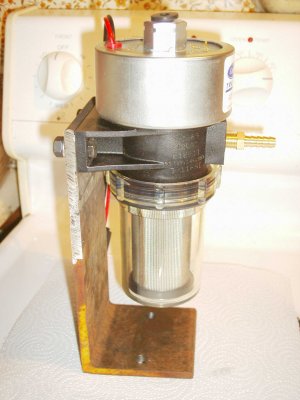

Here is a pic of my pump before I installed it. I made a bracket out of 1/8" or 1/4" steel. I mounted it to the top of the fender where the vacuum "ball" is and relocated the ball. I can take a pic of it installed if you would like.
