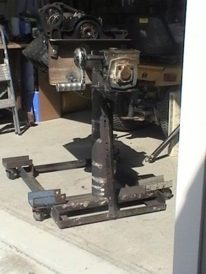

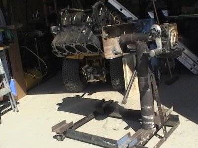

Here's how I hang mine. I use the two top and two center, better balance when rolling over. I'll see if I can find my HF stand with engine on it.

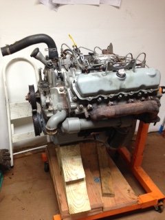

I left the adapter plate on. I blocked up the front to take some weight even though this engine stand held a power stroke for a month without blocking. When I turned it I reblocked it. Use a bottle jack to lift a little then block it up. I like my feet, didn't want to take any chances.
