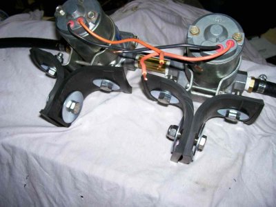

here's a cheaper alternative if you have some
Just hang a couple of Holley black pumps under there and wire it to the stock Lift Pump. At 149 Gph free flow @ 15 psi, you'll be fine. Cut the existing tubing with a tubing cutter, not a cutoff wheel, and bend the line slightly to intersect the rubber hose. Cap off the tubing and leave it hanging in the line clamps for later on when and if you ever need to hook it back up. :confused:
Then attach the rubber line with the hose clamps and use a Tee Tap electrical fitting with 12 ga wiring thru the existing wire loom down there and tie in to the stock pump wire. It'll turn them on and off with the stock pump and the stock pump won't have to work so hard and go south so quick. ;Really
That's what I did, make your own decisions.

the twin holleys shown above...
I know everyone wants to run the latest, greatest, trick cool stuff they see in the ad brochures, and the magazines, and everyone wants what the Jones' down the street got, but the numbers from all these high dollar pump/filter systems aren't as good as my two old black pump holleys in series with the stock L.P..
For less than $200 I put together the twins you see in my post above and under full load with the Banks system (with speedloader) set on KILL #6 I see it drop to about 22-26 psi and that runs my turbo up to the 35-40 psi range.
Not bad for a couple of Holley Black pumps rated at 148 GPH ea. (also...no regulator in there either, just let 'em flow free right thru the stock pump. Takes the load of it as well and keeps the system from running dry on startup.)
:thumbsup:
