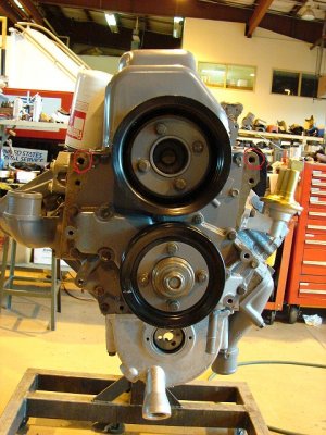

The ground cables go to the bottom front of the block, both sides, 1/2 inch bolts IIRC. If you were close I would have that baby fixed in a couple hours. Electrical is one of my specialties.
The 2 red circles are the proper ground points for the battery cables.
