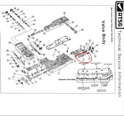

Either the SS1 has quit or the 2-3 shift valve is stuck.
here's the 2-3 shift valve location for ya KCFabrication.
#11.
basic help getting to it;
http://www.oilburners.net/forums/sh...go-s-E40D-HD2-D-reprogramming-kit-(shift-kit)
don't worry,it's nowhere near as intimidating as it looks.1 step at a time and it's easy peasy lemon squeezy.....and actually quite fun imo.no point in installing a kit or anything since you plan to swap trans ♫ but the info will get ya there and back if it's not the solenoid pack.♫ :D
