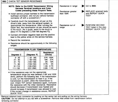

You can check out the TOT. Between the two Yellow wires in the harness, with an Ohm meter. Cold between 32*F & 58*F the resistance is 37K to 58K, at 159*F to 194*F the resistance is 2.7K to 5K, in other words the hotter the TOT is the lower the resistance. Make sure the connector on the pass side of the trans. is plugged in all the way and the wires are not shorted or corroded. To unplug it, just squeeze the latches and pull up on the wires, DO NOT use a screw driver to pry it up, the latches will break off. There is a heat shield next to the connector, make sure it's always there, has to be removed to disconnect.
Edit: It's been known that the solder joints on the CCC solenoid are bad on the solenoid pack.

lol that's kinda funny.iv not heard of one acting in this manner before.well that's cool you grounded the wire directly so you know the converter locks when you do that,cold or warm,so you've eliminated a mechanical failure.so something is going on with the control unit not telling the trans to lock up.
Bill's got ya headed the right direction,by testing the tot.......iv got a chart here somewhere too i think......

ok I have checked the resistance of the TOT it runs 12k with trans fluid cold 30 degrees f outside and sat for a day i warmed truck up drove around till it quit locking up converter and ohms are OL or open ??? oddly enough it does not lock up when I ground converter wire ?? two problems ? one causing both? I know their is a reason I wanted a manual but I cant seem to remember why ?? it would explain why it switches off like a switch was thrown I guess it wass any help greatly appreciated Im guessing solenoid pack but would like to be sure thanks
338
Your gonna have to drop the pan and pull the pack. Maybe you can see the problem than (solder joint)? Ebay has them.
