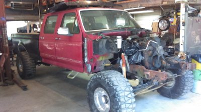

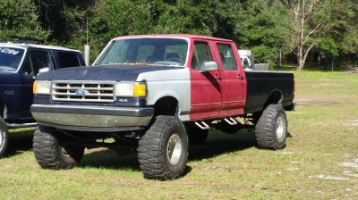

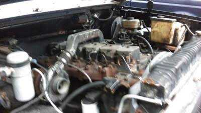

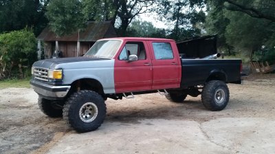

I might have to try loosening it up and see where it likes to sit. It might just work. I want to post pics of the truck but i guess you can't do that from a phone. I'll have to upload em to my laptop so yall can see what I'm working with.

Seriously though, you said the dodge trans sits 2" higher at the output? That could be a serious bind as short as that is to the carrier. I'm betting a custom carrier mount will be in order to take all the bind out of this.

Take a picture of the slip yoke. Does it have enough travel to extend when the rearend drops? Most the time the splines would pull past the seal, but the seal may be preventing it from pulling out and pulling on the carrier.
