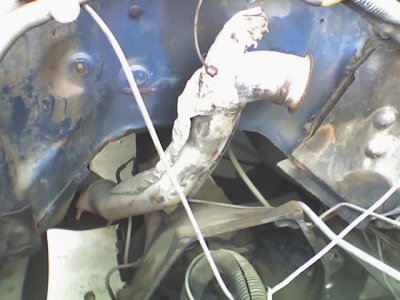

Seekers said:
I've been wanting to put the banks sidewinder on that I purchased a while back and don't have the downpipe that goes with it. Do you guys know if this would work on our trucks? mine is a 1993 supercab...
here's what a gen 2 Banks for an IDI is supposed to look like. It's for sale too :D just the downpipe tho. The rest of the exhaust is going on another truck.
