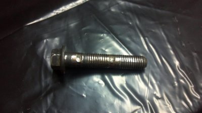

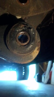

My 93 crew cab had the right front wheel death wobble . I just redid my front end and put in new poly bushings ... my right side I -beam bushing and bolt were beat and sloppy . the radius bushings were OK , but were replaced with poly bushings... everything else appears to be ok , but I'm doing new ball joints anyway :D Got new grade 8 hardware for I-beam bolts 9/16 x 3 1/2 ... nice snug fit and no slop ! also drilled out radius arm bracket rivets and replaced with 1/2" grade 8 hardware...
