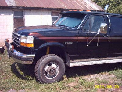

Well it is officially sitting on all wheels and I tested it on the local highway it drives straight and handles fine what I tried to do with it so far. Now I just need to install the np205 and have some driveshafts made, hope it is soon.
Here are some pics, never mind the front bumper it is off on one side and of course I still need to install blocks on the rear axle.

nice work. I am planning on the same thing. I should pick up the donor truck this weekend, Glad to see no modification to the frame are fequired. Looks like it pretty striaghtforward bult in deal. Well alot of work,. but still no kit to buy or custom pieces to make. i did a SAS on a 93 GMC and it was a pain swapping over from the IFS parts and installing the kit. installing high steer and the rest of the engineered components.
Again nice work.
