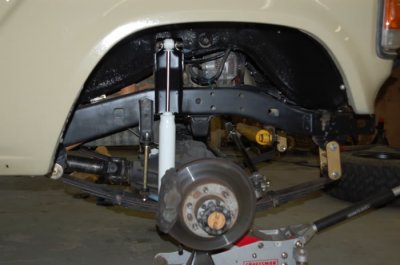

Here is a pic I found, the stab link bracket is at a 90' angle it seems, is this right? the other pic I have looks to be at 80' angle.

The factory bracket is riveted right to the frame and can only go on one way. It follows the contour of the frame like your other pic

That photo is of a 60-series Toyota Landcruiser, right?
Not sure about the model/year but yes that is a landcruiser I believe and You're right there are differences from that to a f350 too. I looked at it this morning and with the measurement I got from DieselBrad the stab link looks just like the one on the pic I posted before the LC.

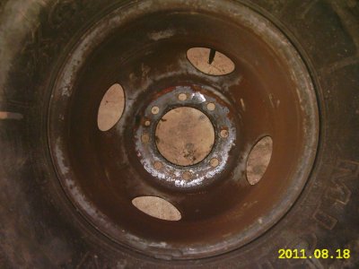

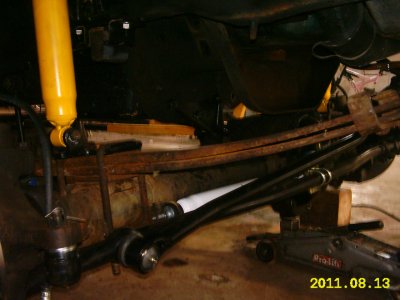

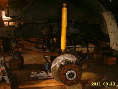

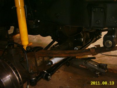

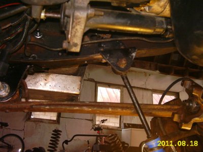

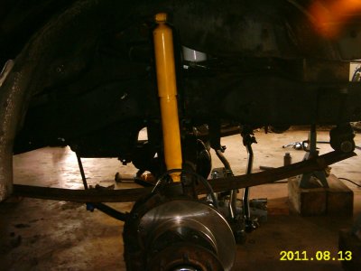

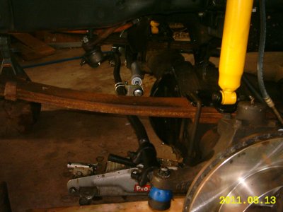

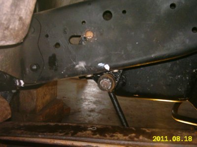

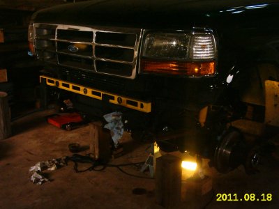

Got some more done this weekend, I have to get the brake hose bracket bolted and the track bar bracket holes drilled then it will be almost all done. Well that and I have to mount My front tires on the 4x4 rims which are different than the 4x2 rims since this last have an extra lock pin.

gonecrazyi
Aug 27, 2008
3,270
florida
Sweet, its coming along. I've got a few drw 4x4 and was going to use the axles in a cc, but man do I want the ride of a coil sprung front.
Diesel_brad
Dunce
Nov 8, 2008
6,099
gilbert pa
You dont need those line up pins. They are just so you stagger the valve stems. Grind or drive those pins out

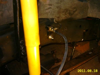

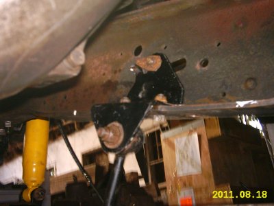

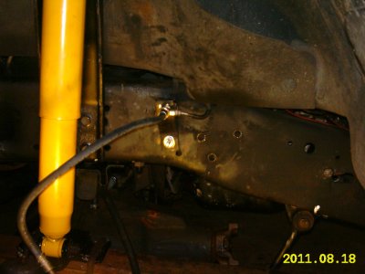

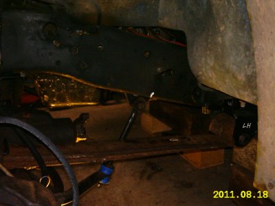

Finished drilling the last holes today after work, I really hope My measuring accurate. Looks good finished the brake hose brackets I made them out of a piece of flat steel and the track bar is installed as well, I removed the pin on both rims so I can install the front wheels next time. I have to bleed the brake lines and put everything else back together maybe this weekend I'll drive it out of the barn :D
