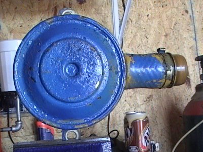

CDR = Crankcase Depression Regulator. Looks like this.
RDT is a hose in place of the CDR that goes into the exhaust or just open to the road. Search for this.
If the diaphram in the CDR is damaged or very dirty (oil sludge) it won't operate right. Can be cleaned using diesel fuel, pour some in it and shake it around, after it's removed.
