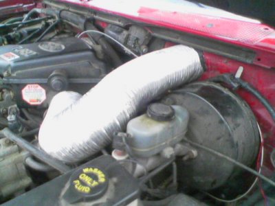

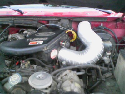

Heres mine. I take it off in the winter so it dont get blocked off with snow, and so it pulls warmer air in.

88beast
Sep 23, 2009
2,219
pa
thats waht i plan on doing you can get a 4 inch y for a wood stove with a flapper in it ill add that to the dryer duct
