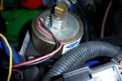

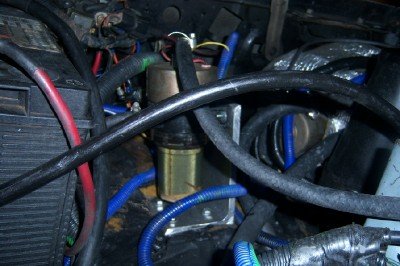

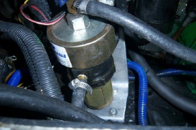

RLDSL, any pics of ur set up? im intrigued by having it under the hood instead of the usual frame mount.
Ask and ye shall receive :D
a little hard to see, but it's behind the passenger side battery on the inner fender. I made a bracket from a chunk of angle aluminum. It's only about a 14" piece of hose from there to the filter . Makes bleeding a snap after cleaning the screen. Usually when I clean the screen on the road, I wash it out with a can of brake parts cleaner and then fill the bowl with tranny fluid for a little extra cleaning and quick bleed off. and can do it all without getting anything but my hands dirty( not even those if I remember to put the gloves on :rotflmao
I have it wired in through a standard bosch relay and a circuit breaker
-------Robert

This is a commercial duty diesel lift pump. it is quite literally 10 times better at sucking fuel than a holley. These things are designed to lift fuel 10 feet straight up ( ever seen how they mount a ****** unit on a refrigerated trailer? the fuel tank generally goes down under the belly and the pump is up in the engine compartment in the ****** unit ) Those pumps are made by Facet, the Dura-Lift and they are the factory lift pump on the new Carrier Transicold and Thermoking ****** units.
That much extra suction is going to translate into that much extra pulll power for the heavy fuel

Nice looking unit.....not sure bout those being mounted in engine comp....messy when cleaning filter etc.
As long as you don't tip it over when you pull it out, no mess ;Sweet
First couple of cleanings I slopped a bit till I got my angle of attack down :D
It's real nice being able to just pop the hood to take a peek at that screen.
Like this last trip. When I put my fresh engine in after the truck sat 8 + months, the front tank got critters in it. Luckily, that screen caught them all and set off the main fuel filter light , a quick stop and clean and switch to the rear tank
and it was clean, so I ran on it the whole way. Didn't have to change the filter. it's still fine ( and a steady diet of biocide has run through the system , I thought I had hit it before storage, but oops)
