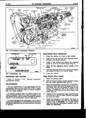

342
Read the last paragragh about the backup lamps. That will tell you if the linkage is set correct. With the key ON engine OFF, select Reverse, check backup lamps for ON.
