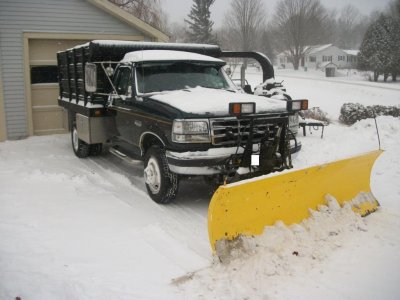

hope my list helps someone;
Bilstein 4600 Series Shocks
Front #24-016179
Rear #24-016186
Federal Mogul - Moog Upper & Lower Ball Joints #K80026/#K8435
Federal Mogul - Moog Inner Tie Rods
#DS1072/#DS1069
Federal Mogul - Moog Outer Tie Rods
#ES2728L/#ES2727R
don't worry yourself over what the kids say too much about the E40D's and D50's boys.
it's just like anything.a little maintenance goes a long way.
contrary to popular believe,the zf5's and d60's fail too.don't let 'em fool ya.
