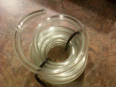

Im using that crappy clear plastic line for the boost line. I don't know how many dang times it has snapped, is there any other type of line I can use?

my glowshift gauge came with some clear flexible tubing. i don't see this stuff being able to crack at all. i have no results with it yet since i have not installed my gauges yet.

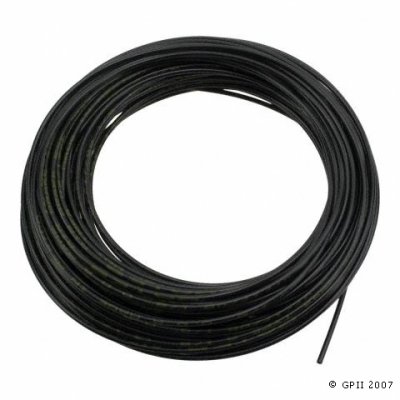

If this is the 1/8 line find a place that sells black 1/8" air line by the foot. This is used on air systems on trucks and is way better then the tightly coiled stuff they sell for gauges. This is a gates number H30002-02 its made out of nylon.
