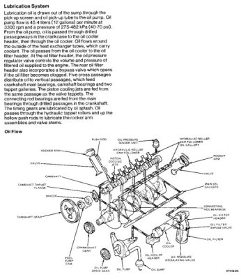

I've posted this quite a few times. Here ya go Al.
The gear oil pump in these engines is a positive displacement and there pretty good size.
Twelve (12) gallons per minute @ 3300 RPM is a lot of oil being pumped.
Yes and it says piston cooling jets fed from same galley as valve tappets....hench why I inquired re timed or constant flow...
It isnt specific about flow..
338
It's constant flow from that oil galley. Tappets have nothing to do with the flow to the Jets.
