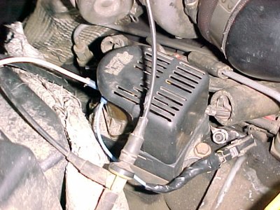

Diezel_Cowboy
It's not like a real ***!
Mar 23, 2004
1,663
A little place called "nun a ya binez!"
yeah it will start the truck if the system is in tip top shape (all glow plugs are good) but if one is bad you are out of luck, HOWEVER, bypassing it will still yield good results with a few bad plugs not to mention the plugs dont come on or cycle when they are not needed which prolongs their life
Bypassing the controller may not be your cup of tea but I would and have recommended it to everyone because it makes perfect sense to me and I have had zero problems with glow plugs since i bypassed the controller a couple of years ago.
