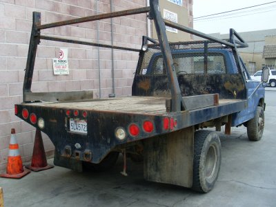

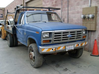

The bed started life on a cab and chassis dually if I remeber correctly. A PG and E truck Cal? It is a 9' bed not an 8'. The truck dually tires come all the way to the edge of the bed exactly, no more room for wider anything. I believe the cab and chassis axle is a bit narrower if I am not mistaken. If the bed was any narrower I would have to add something on to the edges to keep the tires under it, it's that close.
I dont know a thing about cab&chassis trucks, but i have herd they had a different wheel base and the axle was narrower like you said

here's the pic on what it came off of.
