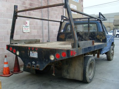

the key thing is the frame width between the commercial chassis vs. the pickup chassis. surprisingly, the pickup axle just barely tucks in there.
here's a repost of the commercial chassis. I know it's a commercial chassis due to the fact there a towbed sitting on it now where the flatbed used to be.

So is this axle a cab and chassis dually?
No, the bed was from a cab and chassis truck, the axle is from a dually truck that came with a bed on it, and 85' to be exact, and is a Dana 70HD. The cab and chassis axle is a little narrower, so the flat bed is a little narrow. It does just barely cover the tires though, any narrower would not cover the tires.
