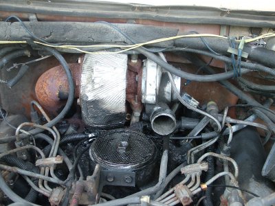

The best picture I have of that early turbo is about the same. It may give some help, so I'll post it anyway. It's the early Banks turbo in an '86'
anybody who says you don't have to beat the crap out of the firewall is FOS. the early Banks kits was a bear to remove let alone a first time install.
