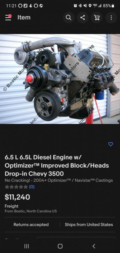

You should consider going brand new as the original 6.2 and 6.5 had issues with the block casting. There's an Optimizer 6500 updated version that was developed for AM General that is supposed to be much improved.
The 6.5 gets a bad rap for not being super durable, but it's hard to dispute the power and fuel mileage that you can get out of one in a 1/2 ton chassis.
Good luck whichever way you end up going.
