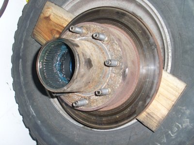

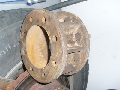

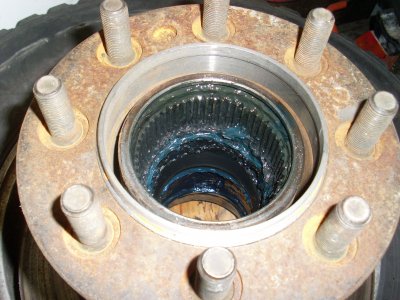

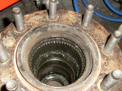

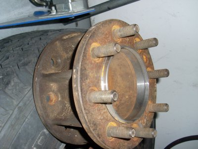

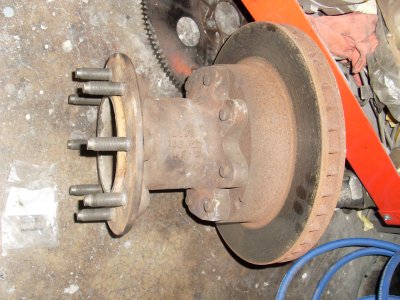

if you're doing real hauling with your truck, I'd suggest holding out for a true pickup dually rear and box. conversion adapters is OK for the fronts, but will play hell with the wheel bearings in the rear.
here's a couple of pics with the fronts with OEM dually hubs, SRW and arrowcraft converted SRW.
