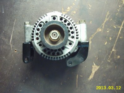

if it's a 3g unit, you can pull the regulator/brush holder and assemble the alternator first and then put it back in.
as always .......see pics....

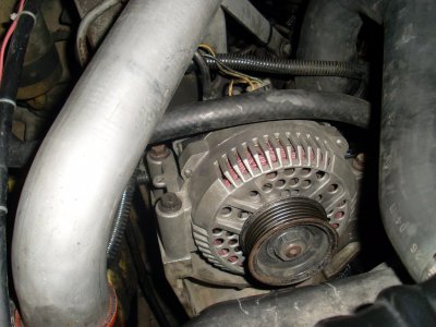

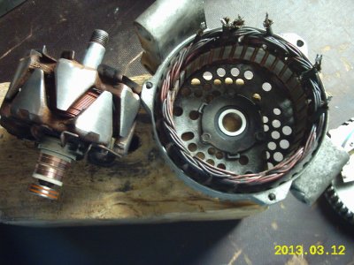

Well I finally got time to do this, I went to napa first and they said they don't carry bearings for an alternator :dunno, so I went to a mom&pop store that rebuilds them and they had them so I installed them on mine and hopefully this is what was causing the squeak, It wasn't so easy to get it apart, I had to undo the wires soldered inside the alternator but after that it was easier, cleaned all the pieces and back it went. Here are some pics in case someone wants to see, btw I'm not sure mine is a 3g after all.

Sure looks like what towcat posted up.. BTW.. Both of you posted some great pics of the how toos with the brushes.. Makes it almost stupid simple seeing pics like that. Makes me want to go out and play with mine... Ron... Don't run with that.. I know somebody is but just not you...:rotflmao:D
