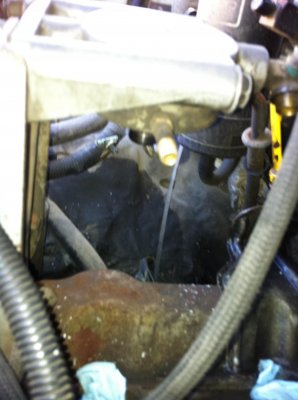

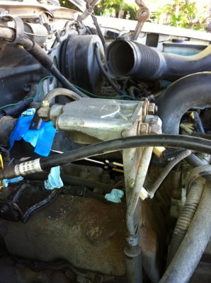

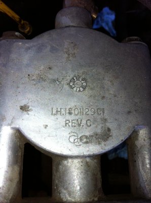

Engine mounted filter head
See attached photos

I dont know the sizes, but the 7.3L uses a filter with a larger thread than the 6.9L. That's why it wont fit. :)
