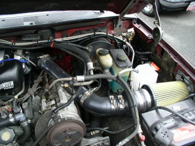

I know what the parts are but could you pan out a little so I could get a better idea of where the system comes from & goes? What is the CDR hooked to?

It looks like the CDR's hooked to the air intake on an old-style ATS turbo. Actually, what little I can see of the box looks identical to mine.
Krawlr, do you have the "snail shell" ATS 088 turbo on your truck? I'm attaching a picture of what mine looks like...

Yea it's the old ATS. The CDR is flipped from it's original position. I still had to weld some tabs on to tilt it forward a little. The scavenger valve is right behind the cab.(I run straight pipe)

What does a scavenger kit do? Is it used with the CDR? What would be the downside to putting the CDR back on as Bank's had intended. Or just plumbing into my intake (homemade). This is what I have to work with:
