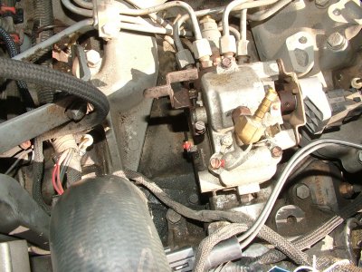

Good write-up, Gary. Here is a picture to help locate the engine number you're referring to. It isn't always easy to find, frequently buried under a layer of grease. Notice I had to wipe it clean. Be aware you cannot always see the entire number, as the sealant sometimes spreads over the first digit or two. In the picture look to the lower right area for the number.
