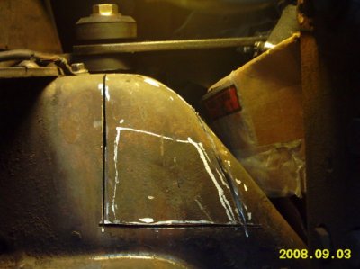

Well since no one want to venture a guess I had to go forward with this, I called the guys at forcummins and asked what they would do, they offer a 94+ a/c pump for that I would need a new bracket and total I would end spending around $450 and still cut part of the cross member so I didn't want to do that and started looking at the 89 ctd a/c pump I already have and cut a section of the cross member that to Me it will not compromise the frame so lets hope I'm right :rolleyes: .
I have a few pictures I know a lone soul will some day appreciate to look before the slaughter.
The cost so far was 0 bc I already had the a/c pump the catch is that when ever I have the pump rebuild I'll have to use the same core since I had to cut the two bolt in the back in order to make it fit. This unit is 10" long, My idea was to find any other unit much shorter if possible with an 8 row pulley but since that didn't succeed I used the same unit minus the rear bracket.

There is only one pic of the a/c pump that I see, looks like You raised it and moved the alt to the right. You are also using some serious turbo twins :D .
I can't do that on mine, I have the fuel filter at the top driver side of the engine but a bit higher and I don't want something so big on the way on top of the IP. My idea is to keep everything on the stock position even dough I use the ford alt but I have a bracket for that. You need the space for those huge turbos and except for the IC pipes there is not much on the way of the stock position for the a/c pump. as long as it doesn't hit the cross member I'm ok now I have to go to the hydraulic hose shop and get them to mate a few hoses together.
