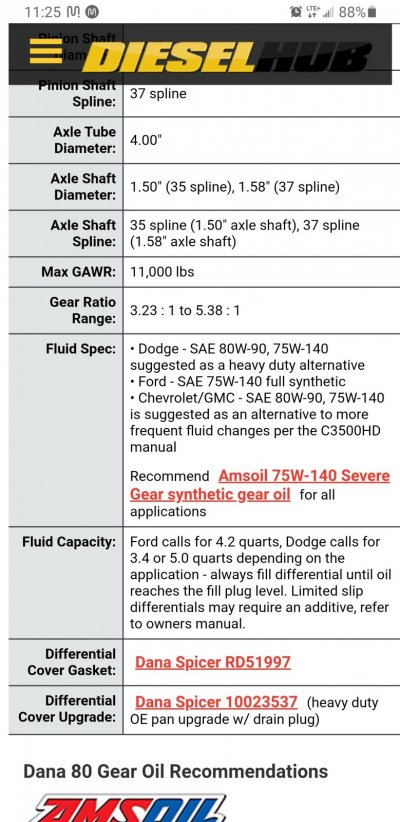

just a update got the truck back about 1 1/2 weeks ago.. she is good to go.. one bearing in the tranny literally fell apart when he took the tranny apart lol... all is good now.. i do need to get the front and rear diffs checked and changed as well...
not familiar with what gear oil is used in the fords etc.. 96 dually
