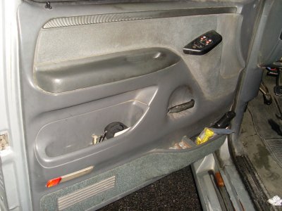

1,442
it looks like any other Custom or XL door panel with power switches.
my truck is an XLT and they add the darn near impossible to clean cloth inserts.
