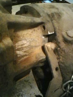

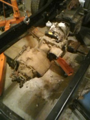

So last night I cut on my US gear to case to make clearance for the shifter of the NP205. I also turned my engine over for the 1st time in 5 years. I was nervous the rings would be rusted to the bores, but a little battery got her to spin. Sounded GOOD also. Didn't run with no fuel ofcourse, but it was still sweat Music. once I get the new transmission bracket built I'll powerwash everything good and remove the transimssions and case so they can get painted. I want everyhing fresh. Oh the y-pip that was still on the engine was full of water so it blew alll of that out into the shop also. Definitely didn't get in the engine, but a good reminder TO GET THIS THING DONE!!

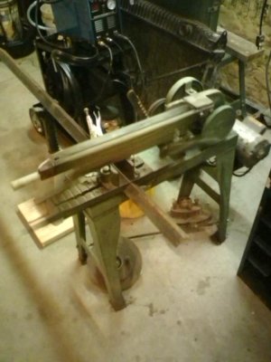

OH and I included an extra shot of my Keller power hacksaw. It looks pathetic, but works really well. I've been amazed by that little thing.
