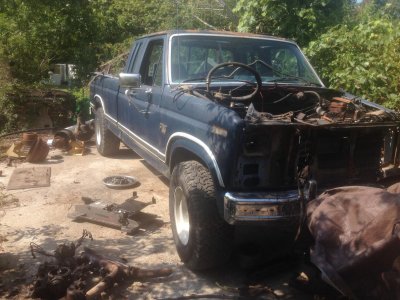

86 f-250 in Sig 2wd. 16.5 rims with 33x12.50 Bfgs
Fit perfect plenty of steering room up front. Back will rub when towing.
