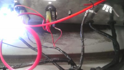

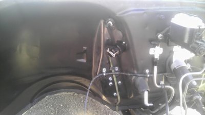

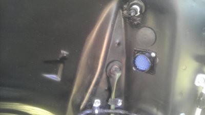

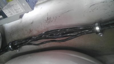

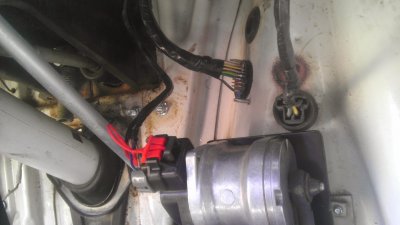

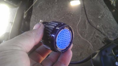

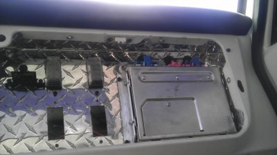

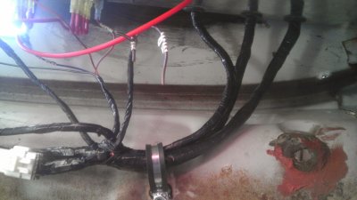

Well I have started working on it again. I also changed it up a little. I'm going full electronic injection on it. I already had the electronic IP and all the sensors. I cut a wiring harness out of a 94 6.5 truck. I then sorted through all the wiring this took time labeled all of it. I got the ECU from a 94 truck also. I made a glove box out of diamond plate aluminum and mounted the ECU in there. I also mounted the auxiliary fuse blocks and relays and also the diagnostic plug. I cut the harness down soldered all connections and shrink wrapped them. I got a military 50 pin circular socket and plug and mounted it on the firewall. There is a guy that makes up to a 6 position chip for the 6.5 this is what I'm going with. I will have cruise control, idle up control, and greater reliability. This way the IP isn't maxed all the time which is ******* it. Here are some pics.

I got the PMD mounted and a heat sink behind it. All the wiring is done inside just got to install the dash parts. I got my new heads in they are the new castings all assembled. I'm getting the pistons cut tomorrow and ordering head studs also. Next two weeks pistons are getting ceramic coated and rings and gaskets ordered. Then the motor is going in finally I can then finish the wiring out side. Here are the pics of the finished glove box.

It is cut out same size as the pmd . I drilled and tapped the heat sink for the pmd screws. I then drilled and tapped for screws to hold it to the box. The pmd is screwed straight to the heat sink with the conductor sheet between them.
