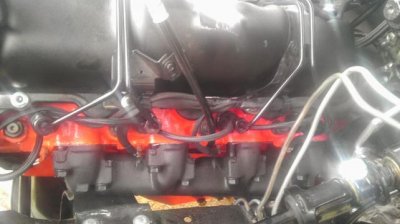

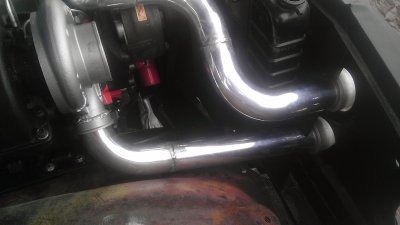

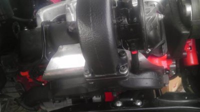

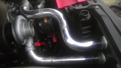

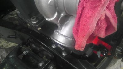

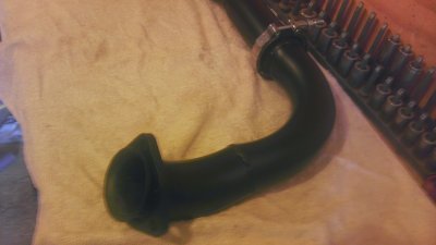

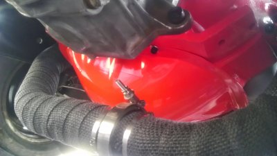

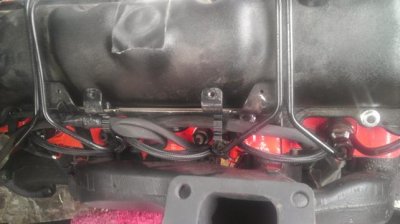

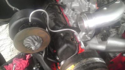

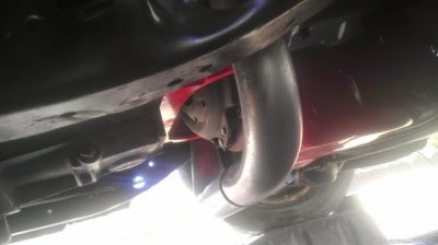

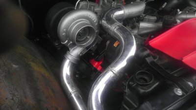

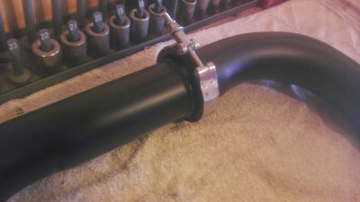

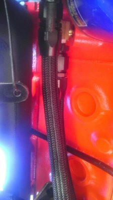

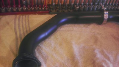

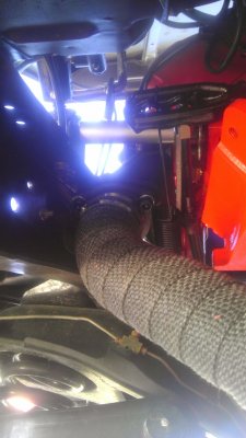

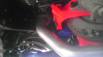

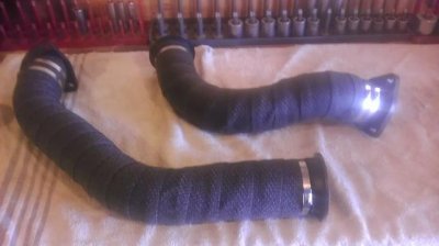

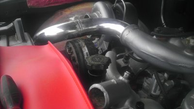

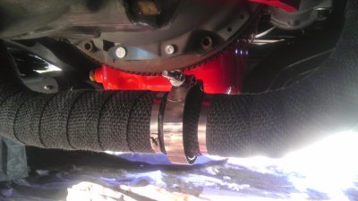

Here is what has been done.
New glow plug harness made and wrapped in high heat sleeving.
New exhaust crossover made, ceramic coated and wrapped.
Intercooler tubes roughed in.
V band welded on turbo outlet.
Turbo oil feed line made.
Oil cooler lines made.
Clutch cover installed.
Interior almost complete.
New injector return lines.
